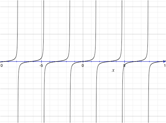

This function calculates the tangent of an angle. The graph below shows the result of the tan( function given input values from –10 to +10.
y = tan( x )
y = tan( x )
