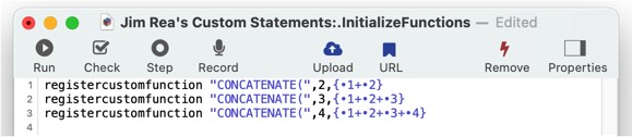

Starting with Panorama X, you can now define the same function more than once, with different numbers of parameters.
registercustomfunction "CONCATENATE(",2,{•1+•2}
registercustomfunction "CONCATENATE(",3,{•1+•2+•3}
registercustomfunction "CONCATENATE(",4,{•1+•2+•3+•4}

Defining Functions in a Custom Statement Library
A good place to define a custom function is in the .InitializeFunctions procedure inside a custom statement library (inside the ~/Library/Application Support/PanoramaX/Libraries folder). If you put your custom function definition code in that procedure (as shown below), it will run automatically when Panorama starts up, and will also run automatically when you use the Libraries>Register Functions and Libraries command in the View Organizer (you should do this each time you change the custom function definitions and want to try them out).

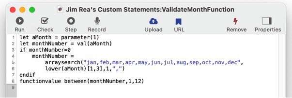

The first step is to write a procedure that analyzes the parameter and determines whether the month is valid or not. This code must culminate in using the functionvalue statement to return the result.
let aMonth = parameter(1)
let monthNumber = val(aMonth)
if monthNumber=0
    monthNumber =
        arraysearch("jan,feb,mar,apr,may,jun,jul,aug,sep,oct,nov,dec",
        lower(aMonth)[1,3],1,",")
functionvalue between(monthNumber,1,12)
I’ll put this procedure in my Custom Statements library, so it will automatically load into memory when Panorama launches. However, this procedure is NOT a custom statement, so I don’t give it an all upper case name. (The name could be anything, it doesn’t have to end in Function, it just shouldn’t be all upper case.)

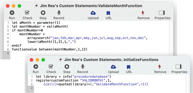

One problem with my .InitializeFunction is that the name of the library database is hard coded into the code. With a slight adjustment this dependency can be removed – this version of the code works the same but will work even if the name of the library database changes, or if this is moved to a different library database.
let library = info("proceduredatabase")
registercustomfunction "VALIDMONTH(",1,
    {call(}+quoted(library)+{,"ValidateMonthFunction",•1)}
Here is the complete code needed to implement this custom function.
