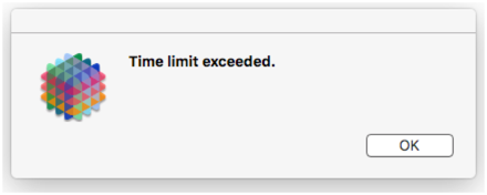

Specifying Maximum Loop Time
In addition to the ability to abort with the SHIFT-COMMAND-ESCAPE key sequence, you can also set up a preference to specify the maximum time that a loop can run. Choose Preferences from the File menu, then click on the Advanced panel. In this panel you can edit the timeout value directly or you can choose from a set of common timeouts from the popup menu. Choose ∞ if you don’t want a timeout, but rather the option to run endlessly forever.
The trick in specifying this value is that you don’t want to make it onerous to wait for if a loop does get locked up, but you don’t want to make the timeout length so short that legitimate loops get cut short because the timer expires before they finish their work.
So now let’s go back to our endless loop example.
firstrecord
loop
    Name = upper(Name)
until info("stopped")
With the timeout preference set to 30 seconds, this loop will run for 30 seconds and then stop with an error, like this.
Note: The loop timeout value is ignored if the disableabort statement has been used, or if early abort has been disabled in the Database Options dialog.
