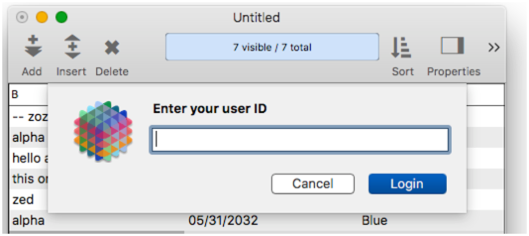

Sheet
This true/false (or yes/no) option specifies whether the dialog should be opened as a “sheet” attached to the current window. If this option is true, like this:
gettextdialog ID,
    "Prompt","Enter your user ID",
    "Sheet","YES",
    "Button","Login","AbortButton","Cancel",
    "Width",300
then the dialog will be attached to the current window, as shown here.
