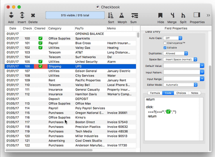

You don’t have to use the letter "Y"
, you can use any text you want. A handy trick is to use an emoji, like this:

You may have noticed that the code in all of these examples begins with a return statement, and then the click:
label. This return statement will be run if the user uses the Tab key to open the standard editor window, then presses Return or Enter. If you want any other actions to run in this situation, put them above the return statement. The return statement ensures that the click code doesn’t run when the editing window closes.
if «»="Y" or «»=""
return
message "Must be blank or Y, no other values allowed"
return
