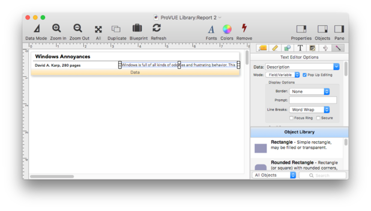

Here is a revised version of our book catalog form that is designed to print the minimum possible amount — a one line description.
Of course when this report is printed it isn’t what we want at all - only the first line of each description is printed. (On the other hand, we have gotten rid of the gaps between the records!)
To fix this problem we need to select the Description object and make it Expandable.
The Description object is the only object that needs to be made expandable. You don’t need to make anything else expandable, including the Data tile. (On the other hand, it doesn’t hurt anything to make the Data tile expandable. Since the Data tile doesn’t contain any data itself it cannot expand on its own. When a data cell (or other variable height object) expands, the tile it is placed on expands automatically. Although you can make any type of object variable height, it only makes sense for objects that can contain variable height data: Text Editor, Text Display, and Image Display.)
Now that the Description object is expandable we get a very nice printed report that even Goldilock’s could love — each record is not too long, not too short, but just right.
